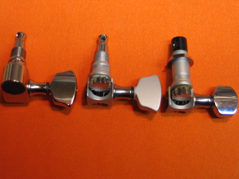

I sell Sperzel tuners and they have a set that mounts like steel string tuners but are made for nylon strings. I have a sample in the shop, I can post a pic later tonight if you like.
PostPosted: Tue Feb 21, 2006 2:20 pm
The one on the right is the the non-standard classical tuner. If this seems like something you would want let me know and I will get you a price and approximate delivery date.
